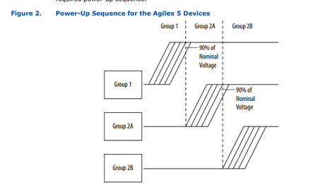

3 months agoRegarding Power-Up Sequence for Agilex 5
Regarding the power sequencing of Agilex 5, the required power-up sequence is specified in the documentation. However, in our case, the sequence was not properly followed. Could you please advise wh...
Farabi_Altera
3 months agoHello,
For Agilex 5 devices, power up sequence is a must to follow to make sure the FPGA power up successfully.
The impact could be functional error in user mode or worst- unable to power up.
