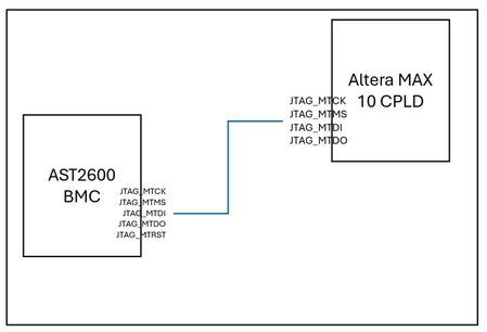

Hi all, the diagram shows that BMC connect to MAX 10 CPLD via JTAG interface. after uploading cpld fw(*.jed format) to BMC, can I use quartus_pgm to program CPLD fw at BMC arm linux system? if p...

Thanks for your kind reply.
Does it support jed format?
is it open source, then i build it into BMC linux system.

1 year agoHi Matthew,
I am afraid it didn't support for jed, just can used for jam/jbc.
For your second qu, yes, the first link is source code of jam player. U can build it on your system.
