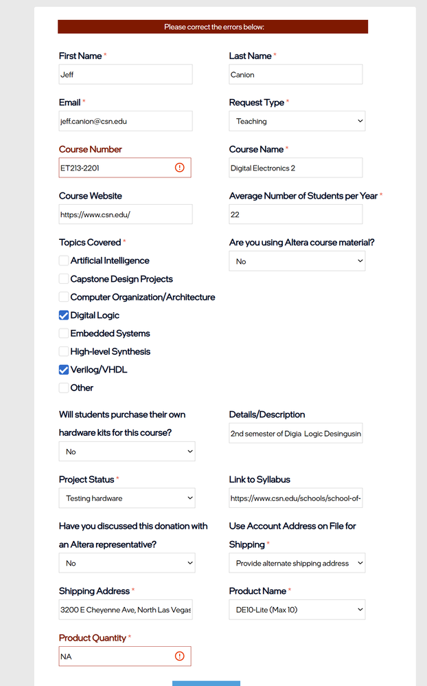

Q1: I am currently teaching Digital Logic Design 2 with Verilog and VHDL. I requested DE10-Lite donations from Intel. I believe the transition from Intel back to Altera FPGA may have been delayed. My concern is that I am unable to complete the form. The fields 'Course' and 'Quality' are blank. Please advise when you can.
Image of request for Quartus and or new versions of ModelSIM? <attache>

Image of the request for donations:
