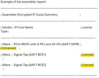

    Did you manage to generate the Assembler report?
    From the report you can see similar view as below to see which is license or unlicensed:
    Assembler report example

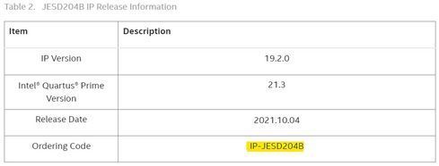

    Based on the JESD204B Intel® FPGA IP User guide under chapter 2.1 Release information, you can see the ordering code for this IP is "IP-JESD204B". You may share the assembler report and User Guide to double confirm with your distributor.
    JESD204B Release information

      While the various IP license names are not totally aligned, I now have enough confidence that the license sold by the distributor is the correct one.
      • The assembler report shows that I need license “JESD204B”
      • The User Guide section 2.1 shows “IP-JESD204B”
      • The distributor sells “IP-JESD204B”
      Thanks for your help. Please close this case.

    Once you run your project compilation, Quartus will automatically create a assembler report, .asm.rpt file.
    ( The assembler report is located in <Project directory>/Output_files/<project_name>.asm.rpt.)
    In this report will show which IP license that you do not have.
