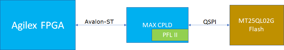

PFL II IP will configure the Agilex using Avalon-ST configuration schemes.
PFL II IP connects with QSPI flash.

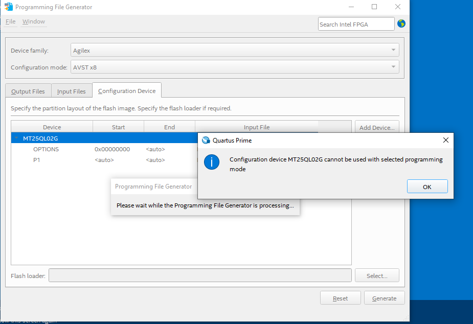

Here we are not able to convert the Agilex *.sof file to *.pof file for QSPI flash in Avalon-ST configuration schemes.
We are facing below error,

    If i changed to CFI2GB flash then i am able to generate the *.POF.
    Please provide the steps to convert the Agilex *.sof file to *.pof file for QSPI flash in Avalon-ST configuration(x8) schemes.

  • I am using Avalon-st x8 configuration method, so cannot use "convert Programming Files" options. Configuration userguide suggest to use "Programming file Generation" options
