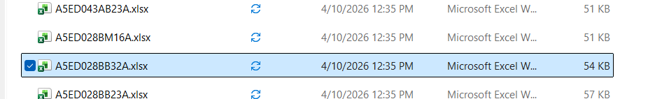

Hi Olivier,
Please download the Net Length report .zip from the link provided by Farabi. I think you are looking for the following highlighted ones.
