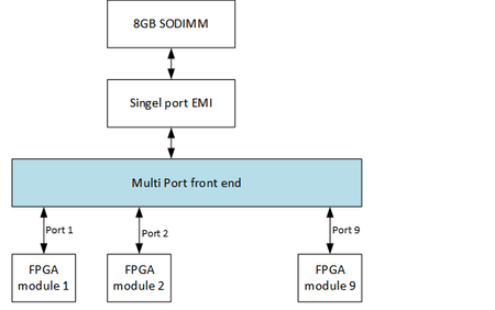

3 months agoMulti Port front end IP for the single port DDR4 memory controller - Stratix10 TX
Part 1ST085EN2F43I2LGAS Do we have IP core details or reference design for the Multi Port front end IP for the single port DDR4 memory controller. What we need is one external memory and EMI share...
AdzimZM_Altera
3 months agoHi amol,
We don't provide the MPFE IP core for Stratix 10 devices.
You may create a MPFE-like design using the bridge and interconnect logic in Platform Designer.
For example, if multiple FPGA modules need to access the same EMIF IP , you need an EMIF IP and multiple Avalon Memory Mapped Pipeline Bridges in Platform Designer.
The bridges can be connected to the EMIF IP through a master.
The interconnect logic will be handle by Platform Designer.
The FPGA modules then can connect to slave of the bridges.
