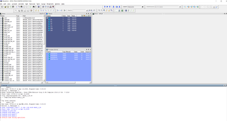

Model Sim "Invalid time string specified" Error

Hi, I download the Quartus Prime 24 Lite edition along with the Questa pro 24 edition and tried running my simulation again but it did not work.
I am using Windows.
