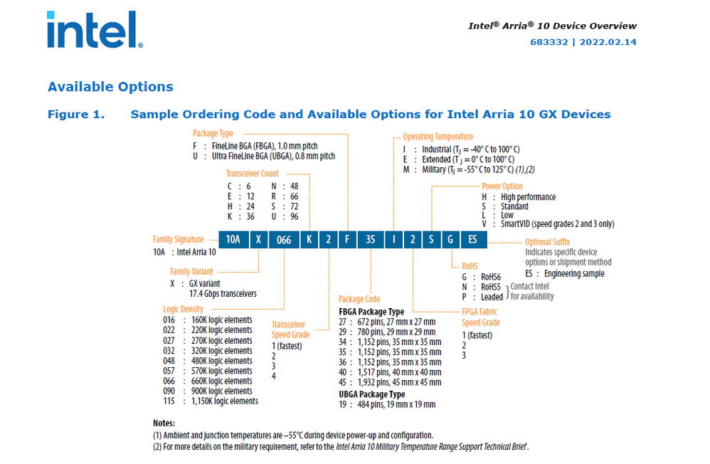

Trying to order an Arria 10 OPN, and would like to understand the ordering info.
In the picture above, it mentions the package type and package code.

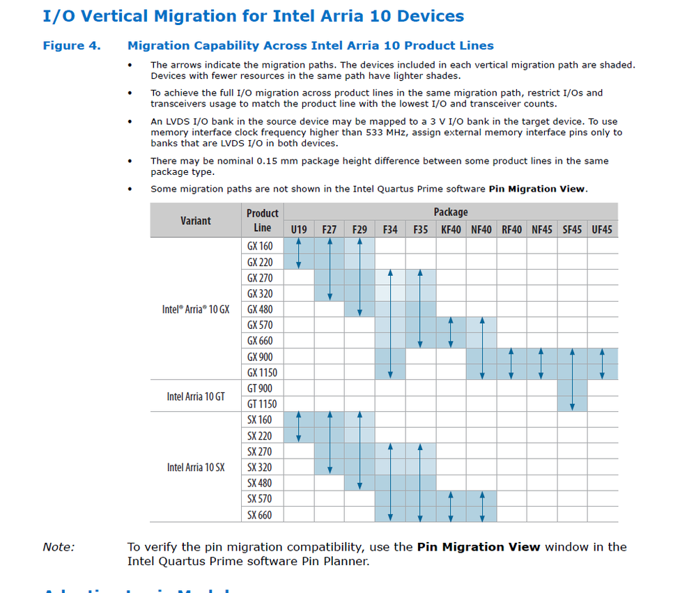

In the I/O migration page below, there is a table which mentions package as "KF40" and "NF40". What does the K and N signify here?.
Document:
A10-OVERVIEW
Version: 2022.02.14
  • Hi MK_ABQ,
    Sorry for the delay in response. It is just a variation of the package plan of Intel Arria 10 devices.
    You may refer to the details of IO mentioned in the table below in A10-OVERVIEW:
    Arria 10 GX Devices Table 8, Page 11
    Arria 10 SX Devices Table 14, Page 16
