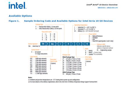

Trying to order an Arria 10 OPN, and would like to understand the ordering info.
In the picture above, it mentions the package type and package code.
In the I/O migration page...

Hi MK_ABQ,
Sorry for the delay in response. It is just a variation of the package plan of Intel Arria 10 devices.
You may refer to the details of IO mentioned in the table below in A10-OVERVIEW:
Arria 10 GX Devices Table 8, Page 11
Arria 10 SX Devices Table 14, Page 16

3 years agoHi MK_ABQ,
