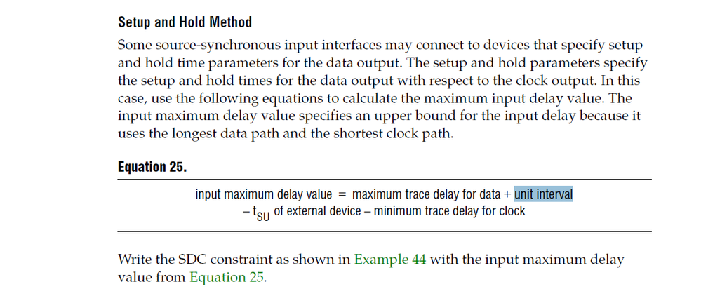

    One more question for AN433 page46.
    what's the unit interval here?
