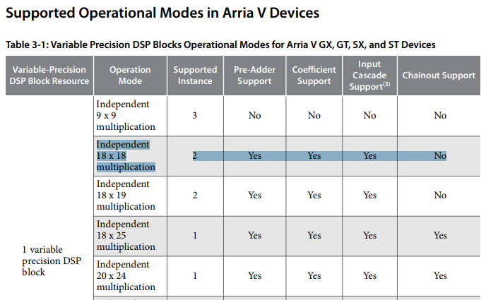

In a project done using Arria V FPGA (5AGXFB1HF35I3), I'm using an IP (LPM_MULT) with the following properties:
  1. dataa and datab input width - 16bit
  2. result output width - 32bit
  3. Signed
  4. Two clock pipelines
  5. With clken and aclr
I have a component with 2 multipliers and 2 adders (implementing a FIR), and since this component is instantiated many times across my design (along with other, different components that use DSP blocks), I want to save up as many DSP blocks as possible.
According to the Arria V handbook, 2 multipliers can fit in 1 DSP block:
According to the Quartus 18.1 compilation report I see that each multiplier uses 1 DSP block, instead of 2 multipliers using 1 DSP block. This causes Quartus to use all the available 920 DSP blocks.

    If you're talking about what they're saying here:
    The following Intel® Quartus® Prime IP cores are supported for the Arria® V variable precision DSP blocks implementation:
    • LPM_MULT
    • ALTERA_MULT_ADD
    • ALTMULT_COMPLEX
    • ALTMEMMULT
    Then yes, I've used the LPM_MULT IP.
