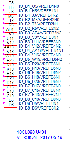

I am designing a custom board with Cyclone 10 LP FPGA - 10CL080YU484A7G. I have the following questions:
a) Should the VREFB pins be connected to Ground or VCCIO? I use same IO voltage of...
