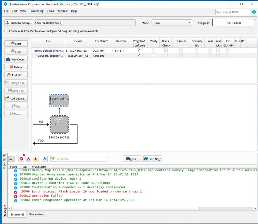

Generating a JIC with EPCGX30CF32 to program a serial flash by Convert Programming files. However Quartus shows no Flash Loader IP after first device programmed. Could you upload a proper flash loader image for EP4CGX30F32?
Flash Loader IP not loaded on device index1

      It is the same error message by version 24.1

      I tried the other USB blaster but it is the same error.
      I also tried to generate JIC file as the thread and it is the same error.

    No issue to download generic SOF into Cyclone IV GX FPGA.
  • FvM's avatar
    it's not necessarily a defective SFL image. Can be also a JTAG problem or unexpected reconfig happening at the target system.
    You didn't report the used Quartus version. I would try to load sfl_enhanced_ep4cgx30cf23.sof and alternatively sfl_ep4cgx30cf23.sof manually and try flash action with disabled sfl programming.

      I could download sof via JTAG into FPGA without any issue. Try to convert JIC with flash loader by both Quartus standard version 18.1.1 & 23.1.1 and get the same error.
