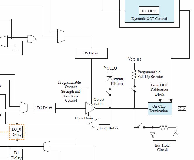

--- Quote Start --- I found the menu responsible for this in the pin planner. According to "this page" (https://www.altera.com/support/support-resources/knowledge-base/solutions/rd01112011_164.html) there is no way around this. Also there is nothing useful in the "pin connection guidelines" for cyclone5 devices.. So is there a way to remedy this? --- Quote End --- That indicates that before a device is configured, and during configuration, the weak pullups will be enabled on the I/O pins. However, you can configure the I/Os to have no weak pullup and no bus hold, so a output that is disabled will only source the leakage current (between -30uA and +30uA per datasheet). BTW 30uA at 3.3V is about 110K effective ohms (minimum; will be higher for lower currents) so even with the weak pullup disabled there will be a pullup/pulldown of something on the order of 110K to 220K or so ohms per I/O. Picture of the I/O structure:https://alteraforum.com/forum/attachment.php?attachmentid=15362&stc=1 - Altera_Forum

Honored Contributor
The first image is what I would expect to see; each bar is about twice the height of the previous bar.
The other two images appear to have an added bias (ie, base value) compared to the first image. If as you say the resistor values are 300-600-1200-2400-4800-9600-19200-38400-76800 (like the baud rates...) then if the passive pullup were enabled, typically about 25K, it would really start to affect the values above 9600 rather dramatically, enabling a 25K pullup to H, when your resistor is pulling to L, forming a voltage divider. Just my suspicion based on your waveforms. - Altera_Forum
