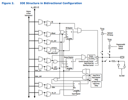

Does altering the FPGA IO standard actually change something in hardware?

VCCIO if powering the IO banks of the IO , depending of where the IO is located.
eg. If you power VCCIO -> 3.3V, the IO standard located in that IO bank should be 3.3V based IO.
The IO assignment in Quartus pin planner must be aligned with the physical setup on your board.regards,

You are specifically asking if changing the IO-Standard affects input signal processing. Short answer is, as long as you don't activate Schmitt Trigger or use a completely different IO type (e.g. voltage referenced or differential), it does not. Input threshold is a partly affected by actual bank voltage but less than proportianal for MAX10 series according to datasheet.
An IOE description beyond the details given in Device Manual isn't publically available, I fear.

Yes, I've got that already. :-)
The only thing I needed was the unambiguous answer to the question in the heading of the topic. Something like "Yes, there are some setup in the hardware, but we won't tell which exactly. Use the software!". :-D
