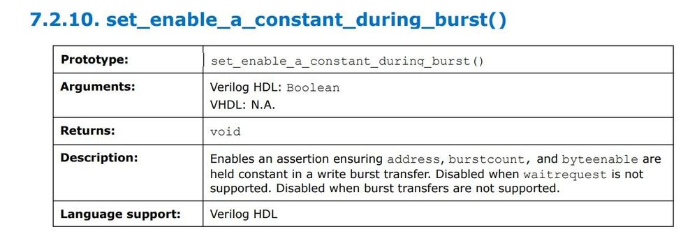

You may checkout the user guide below section 7 on Avalon-MM Monitor :
https://www.intel.com/programmable/technical-pdfs/683439.pdf

@RichardTanSY_Altera , thank you for your response.
The information that you shared is already giving a good idea about the functionality. It would be great if there are some more information directly pointing "Avalon-MM Monitor" IP.
