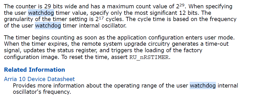

Hello Farabi,
actually yes, as pointed out in my last post I'm missing answers concerning the Watchdog Timeout:
- What is the unit of the watchdog timeout register? This is not specified in its datasheet/documentation.
- You stated "Please make sure the watchdog timeout not too. eg. Dont set RU_WATCHDOG_TIMEOUT = 0xFFF (this is too long)". Why is this too long? I am missing any restrictions in the respective datasheet.
best regards
Fabian
- Farabi_Altera8 months ago
Hello Fabian,
The watchdog timer is range between 1/f (2^0) and 2^29. If you convert to seconds. the range is between 1/7.9Mhz(1.26ns) ~ 67 seconds.
regards,
Farabi
