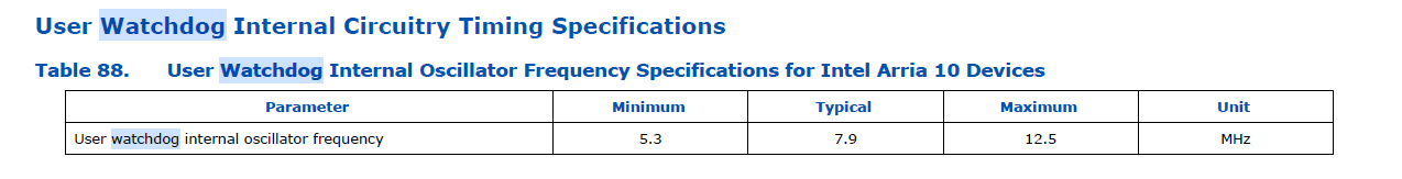

I'm still missing an answer to the Watchdog Timeout:
- What is the unit of the watchdog timeout register? This is not specified in its datasheet/documentation.

Hello Fabian,
A unit of the watchdog timer is 1/f, and f is the frequency of internal oscillator.
Based on datasheet, by right it should be 1/7.9MHz for a unit time (nominal calculation).
