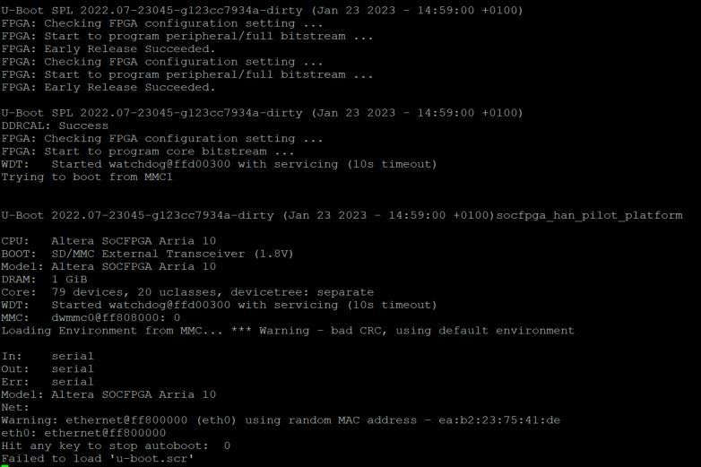

The SOC start-up seems to be ok, but the FPGA does not get configured:
Boot Console Arria 10 SOC
When i start the board without SD-Card, put it in, and then connect with the debugger and start the system with the Debugging U-Boot script. The system boots and the FPGA gets configured…
The start-up runs like from SD-Card, but the FPGA gets configured!

I recompiled U-Boot with #define DEBUG in include\configs\socfpga_common.h and found these error:
No configuration specified, trying default…
Found default configuration: ‘config-1’
FPGA: FPGA node count: 2
FPGA: fpga-periph-1
FPGA: fpga-core-1
FPGA: Start to program core bitstream …
FPGA: Data offset was found.
Can’t get ‘load’ property from FIT 0xffe24ec0, node: offset 248, name fpga-core-1 (FDT_ERR_NOTFOUND)
FPGA: No loadable was found.
FPGA: Using default DDR load address: 0x400 .
FPGA: External data: offset = 0x582d4, size = 0x1dcfb44.
blk_find_device: if_type=6, devnum=0: [email protected], 6, 0

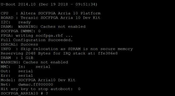

I load the Terasic prebuild Image Linux LXDE Desktop (Kernel 4.9.78-ltsi) to my SD-Card and the configuration of the FPGA worked as expected:
Boot Console Arria 10 SoC Terasic Prebuild SD-Card
They used the old boot-flow in their reference designs, but i need to use the new U-Boot flow, because I want to start the new development with a current Quartus version.

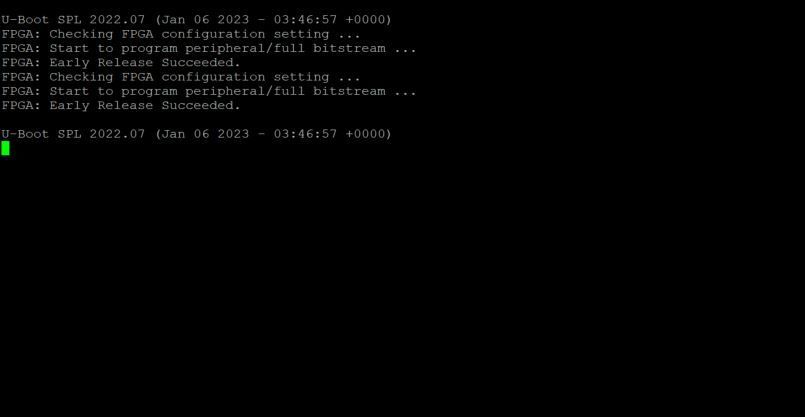

Hi @aikeu,
Unfortunately, the pre-made SD card you mention does not work. U-Boot starts booting but then gets stuck:
Boot Console Arria 10 SOC Intel SoCDK Preebuild SD-Card

- aikeu
Hi LFrin,
Seems that it stucked at trying to perform DDRCAL, it will shows DDRCAL failure after some time if I am correct.
Maybe as you mentioned the pre-built sd image not fully suitable. Anyway can make sure that the SW5 MSEL of your board is already configured to boot from sd card, refering to the HAN Pilot Platform Hardware Manual?

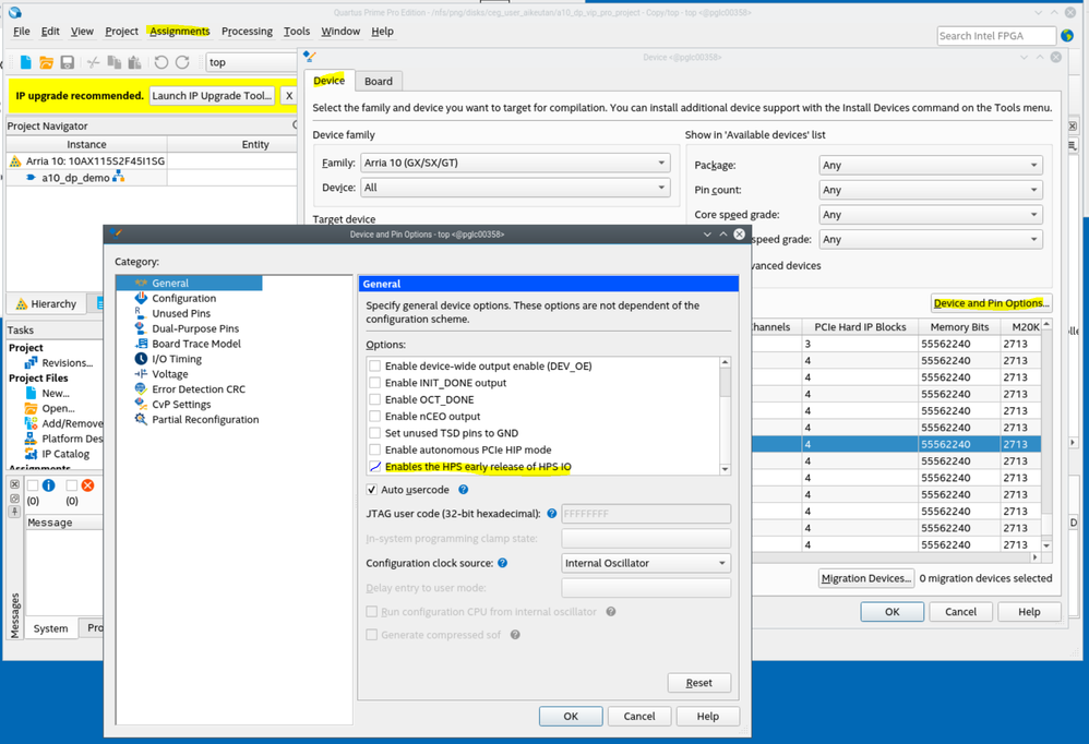

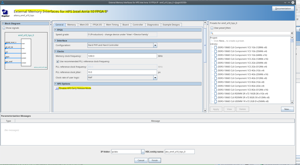

Can check if the below has been enabled for your early IO release build?
To follow the new build flow referring to Appendix - Reducing Arria 10 Fabric Configuration Time ( https://www.rocketboards.org/foswiki/Documentation/BuildingBootloaderCycloneVAndArria10#Appendix_45_Reducing_Arria_10_Fabric_Configuration_Time ), the below items should be checked.
