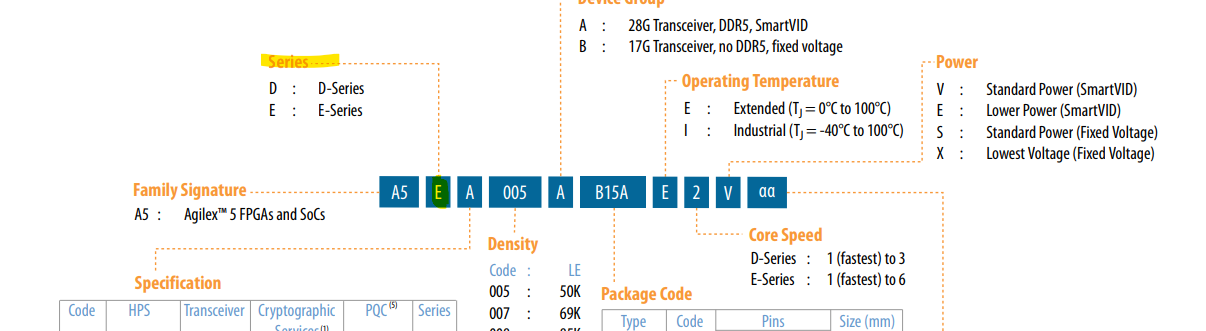

    • FakhrulA_altera's avatar
      FakhrulA_altera
      Hi ohfpga1,
      Could you let me know whether it is a D-series or E-series?
      Fakhrul
    FakhrulA_altera
    Hi ohfpga1,
    Based on my internal research, the estimated 028 bitstream size is 98 Mbits.
    Fakhrul
    • ohfpga1's avatar
      ohfpga1
      Hi Fkhrul
      thanks a lot for your answer. Device is a A5ED028B
      regards
