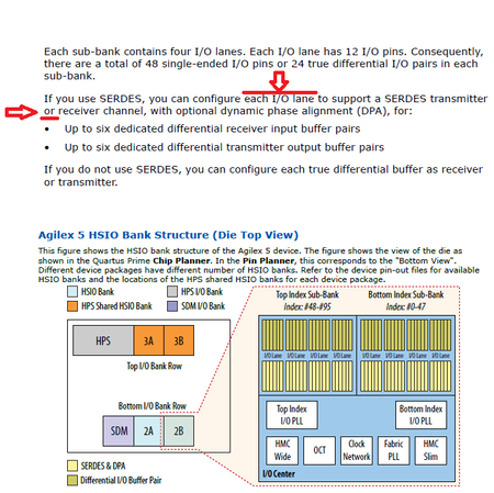

Hello It's unclear for me about how to use IO LANE with SERDES functionality. Is this mean that one LANE can only work as TX or RX block in SERDES mode? If yes, if whole one LANE is set to (f...

I didn't yet start designing with Agilex FPGA, just have Arrow AXE5000 Development Kit for evaluation purposes. Thus I can't answer your question from own experience.
You are quoting Agilex 5 General-Purpose I/O User Guide, 2.1. HSIO Bank Overview. I also read the description so that an I/O lane can be either used for SERDES RX or TX. But as a the title says, it's only an overview.
For detailed specification of differential pin constraints you should refer to Agilex 5 LVDS SERDES User Guide. There are e.g. complex rules for sharing I/O banks between single-ended and differential pins. Finally, it's most likely simpler to evaluate the feasibility of a specific pin assignment in Quartus.
