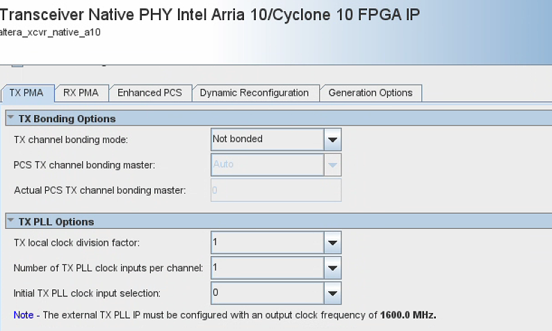

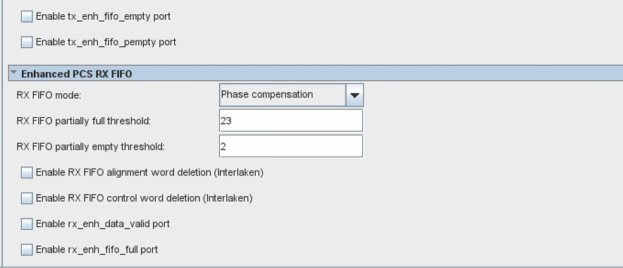

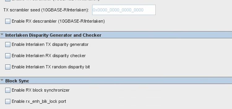

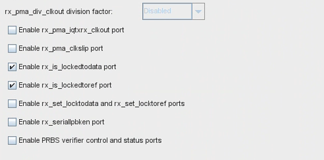

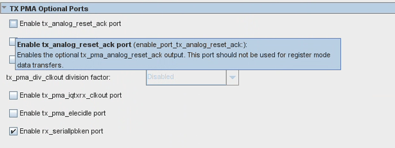

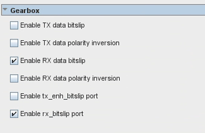

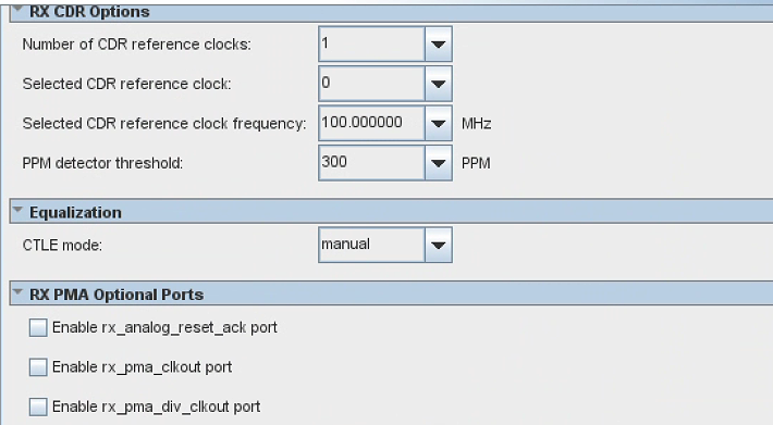

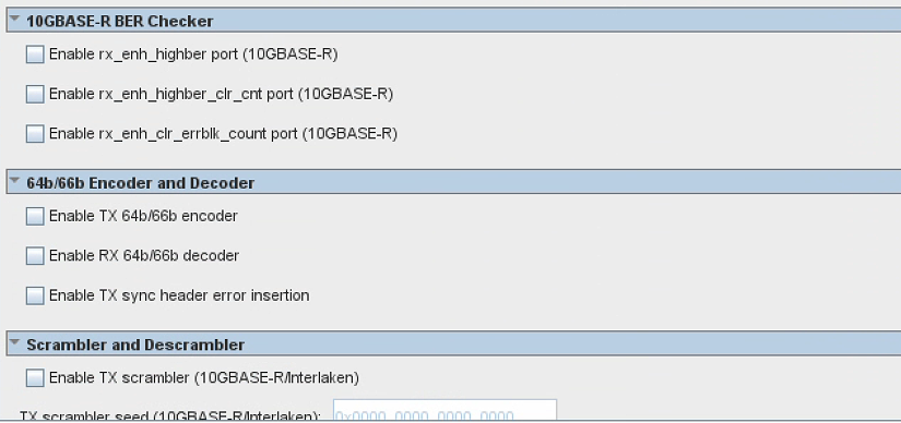

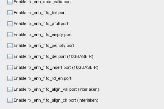

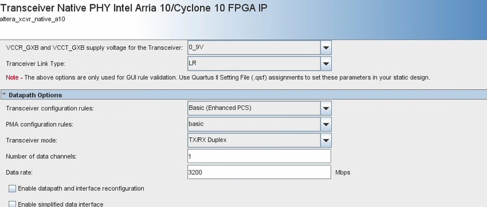

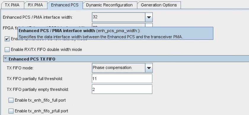

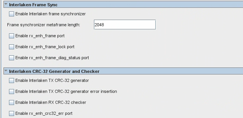

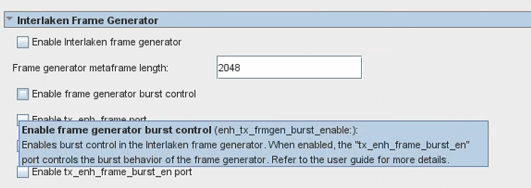

Hi, recently I am trying to debug cyclone 10 gx transceivers, and the settings are as the figures above.
After reseting, I first send 32'h12345678 as the control world, and set tx_control[1:0] = 2'b10. During this time, in my logic I using rx_bitslip to slip the bits until rx_parallel_data is equal to 32'h12345678. After that, I continually send incremental counter value through transmitter with tx_control[1:0] = 2'b01, but the receiver gets rx_control[1:0] equal to 1, 2, 3, changing all the time, which is shown as following figure.
So, did I set parameters wrongly? Or how can l solve it? Thank you.

    Before using block synchronization, your original approach relied on sending a custom training word like 0x12345678 together with tx_control flags and then manually bit-slipping until the receiver matched that pattern. This method can work only if the word boundary remains stable after alignment, which is not true in your current configuration because the RX phase‑compensation FIFO can shift the data grouping internally. As a result, even if you successfully match 0x12345678 at one moment, the FIFO may later realign the data by bytes, breaking your alignment silently and causing rx_control to appear to rotate or change unpredictably. Moreover, 0x12345678 is not a strongly structured or repetitive pattern, so the receiver has no inherent way to verify long-term consistency of the alignment. Without block synchronization or a robust detection mechanism, this leads to a fragile system where alignment appears to work briefly but cannot be maintained.

    Enable the RX block synchronizer, and transmit a simple, highly repetitive training pattern such as 0xBCBCBCBC with tx_control held at zero (so all bytes are treated as normal data), allowing the receiver to observe a stable, structured bitstream; the RX block synchronizer continuously scans different bit offsets and monitors for consistent block delineation, and once it detects a stable boundary it asserts rx_enh_blk_lock, indicating that word alignment is achieved; only after this lock signal becomes stable should the transmitter switch from the training pattern to real payload data (for example, a counter), while the receiver begins accepting data, and during normal operation the design should continue to monitor rx_enh_blk_lock and revert to the training phase if lock is lost, ensuring robust and self-correcting alignment without relying on manual bitslip or tx_control markers.

    Also, just to make sure I am clear, expected settings
    ON RX SiDE
    RX FIFO mode = Phase compensation
    Enable block sync = ON
    Enable rx_enh_blk_lock = ON
    Enable rx_bitslip = optional (not needed anymore)
    • SiWu's avatar
      SiWu
      Thank you for you reply. But unfortunately, when I enable Rx block synchronizer, error appear, as shown in the following figure.
      • Ash_R_Altera's avatar
        Ash_R_Altera
        The Rx block synchronizer works when 'Enhanced PCS/PMA interface width' = 40 or 64, 'FPGA fabric / Enhanced PCS interface width' = 66 and 'Enable RX data bitslip' = Unchecked.
        Please try these settings.
