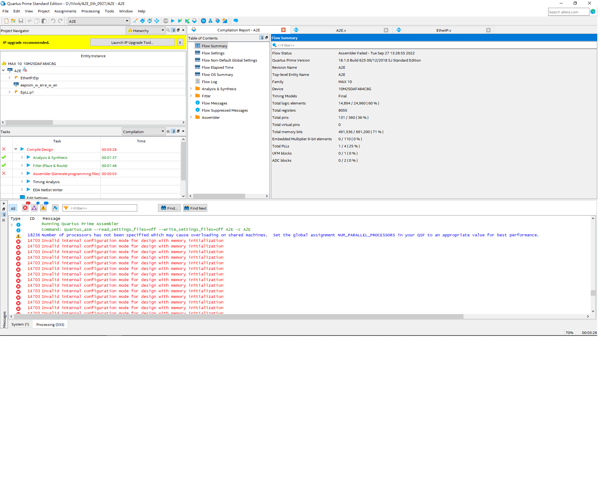

I put Ethercat IP (license from Beckhoff) on MAX10 (10M25DAF484C8G) .
When I use quartus 18.1 compile the project, at Assembler stage, show 14703 at message console.
I can not modify any Ethercat IP source code, because it is black box.
What can I do to eliminate all these 14703 errors ?
Thank you.

    • The assembler report is located in <Project directory>/Output_files/<project_name>.asm.rpt.
    And for privacy, you can reply/attach your file in private message.
    • poming's avatar
      poming
      Hi AR_A_Intel,
      I copy my Assembler report and Flow report as follows.
      Please help to see if any clues.
      Thank you.

      Info: *******************************************************************
      Info: Running Quartus Prime Assembler
      Info: Version 17.1.0 Build 590 10/25/2017 SJ Standard Edition
      Info: Processing started: Wed Sep 28 10:05:19 2022
      Info: Command: quartus_asm --read_settings_files=off --write_settings_files=off A2E -c A2E
      Warning (18236): Number of processors has not been specified which may cause overloading on shared machines. Set the global assignment NUM_PARALLEL_PROCESSORS in your QSF to an appropriate value for best performance.
      Error (14703): Invalid internal configuration mode for design with memory initialization
      Error: Quartus Prime Assembler was unsuccessful. 60 errors, 1 warning
      Error: Peak virtual memory: 4760 megabytes
      Error: Processing ended: Wed Sep 28 10:05:22 2022
      Error: Elapsed time: 00:00:03
      Error: Total CPU time (on all processors): 00:00:03

      to the terms and conditions of the Intel Program License
      Subscription Agreement, the Intel Quartus Prime License Agreement,
      the Intel FPGA IP License Agreement, or other applicable license
      agreement, including, without limitation, that your use is for
      the sole purpose of programming logic devices manufactured by
      Intel and sold by Intel or its authorized distributors. Please
      refer to the applicable agreement for further details.
      ; Flow Summary ;
      ; Flow Status ; Assembler Failed - Wed Sep 28 10:05:22 2022 ;
      ; Quartus Prime Version ; 17.1.0 Build 590 10/25/2017 SJ Standard Edition ;
      ; Revision Name ; A2E ;
      ; Top-level Entity Name ; A2E ;
      ; Family ; MAX 10 ;
      ; Device ; 10M25DAF484C8G ;
      ; Timing Models ; Final ;
      ; Total logic elements ; 14,856 / 24,960 ( 60 % ) ;
      ; Total combinational functions ; 12,074 / 24,960 ( 48 % ) ;
      ; Dedicated logic registers ; 8,055 / 24,960 ( 32 % ) ;
      ; Total registers ; 8055 ;
      ; Total pins ; 131 / 360 ( 36 % ) ;
      ; Total virtual pins ; 0 ;
      ; Total memory bits ; 491,536 / 691,200 ( 71 % ) ;
      ; Embedded Multiplier 9-bit elements ; 0 / 110 ( 0 % ) ;
      ; Total PLLs ; 1 / 4 ( 25 % ) ;
      ; UFM blocks ; 0 / 1 ( 0 % ) ;
      ; ADC blocks ; 0 / 2 ( 0 % ) ;
      ; Flow Settings ;
      ; Option ; Setting ;
      ; Start date & time ; 09/28/2022 10:02:23 ;
      ; Main task ; Compilation ;
      ; Flow Non-Default Global Settings ;
      ; Assignment Name ; Value ; Default Value ; Entity Name ; Section Id ;
      ; COMPILER_SIGNATURE_ID ; 66325072577943.166433054310136 ; -- ; -- ; -- ;
      ; MAX_CORE_JUNCTION_TEMP ; 85 ; -- ; -- ; -- ;
      ; MIN_CORE_JUNCTION_TEMP ; 0 ; -- ; -- ; -- ;
      ; MISC_FILE ; EpLL_bb.v ; -- ; -- ; -- ;
      ; MISC_FILE ; EpLL.ppf ; -- ; -- ; -- ;
      ; MISC_FILE ; EEpLL_bb.v ; -- ; -- ; -- ;
      ; MISC_FILE ; EEpLL.ppf ; -- ; -- ; -- ;
      ; OUTPUT_IO_TIMING_FAR_END_VMEAS ; Half Signal Swing ; -- ; -- ; -- ;
      ; OUTPUT_IO_TIMING_NEAR_END_VMEAS ; Half Vccio ; -- ; -- ; -- ;
      ; PARTITION_COLOR ; -- (Not supported for targeted family) ; -- ; -- ; Top ;
      ; PARTITION_FITTER_PRESERVATION_LEVEL ; -- (Not supported for targeted family) ; -- ; -- ; Top ;
      ; PARTITION_NETLIST_TYPE ; -- (Not supported for targeted family) ; -- ; -- ; Top ;
      ; POWER_BOARD_THERMAL_MODEL ; None (CONSERVATIVE) ; -- ; -- ; -- ;
      ; POWER_PRESET_COOLING_SOLUTION ; 23 MM HEAT SINK WITH 200 LFPM AIRFLOW ; -- ; -- ; -- ;
      ; PROJECT_OUTPUT_DIRECTORY ; output_files ; -- ; -- ; -- ;
      ; SYNTHESIS_ONLY_QIP ; On ; -- ; -- ; -- ;
      ; Flow Elapsed Time ;
      ; Module Name ; Elapsed Time ; Average Processors Used ; Peak Virtual Memory ; Total CPU Time (on all processors) ;
      ; Analysis & Synthesis ; 00:01:36 ; 1.0 ; 5000 MB ; 00:01:46 ;
      ; Fitter ; 00:01:14 ; 1.4 ; 5916 MB ; 00:02:22 ;
      ; Assembler ; 00:00:03 ; 1.0 ; 4760 MB ; 00:00:03 ;
      ; Total ; 00:02:53 ; -- ; -- ; 00:04:11 ;
      ; Flow OS Summary ;
      ; Module Name ; Machine Hostname ; OS Name ; OS Version ; Processor type ;
      ; Analysis & Synthesis ; TWTN1PC1005 ; Windows 10 ; 10.0 ; x86_64 ;
      ; Fitter ; TWTN1PC1005 ; Windows 10 ; 10.0 ; x86_64 ;
      ; Assembler ; TWTN1PC1005 ; Windows 10 ; 10.0 ; x86_64 ;
      ; Flow Log ;
      quartus_map --read_settings_files=on --write_settings_files=off A2E -c A2E
      quartus_fit --read_settings_files=off --write_settings_files=off A2E -c A2E
