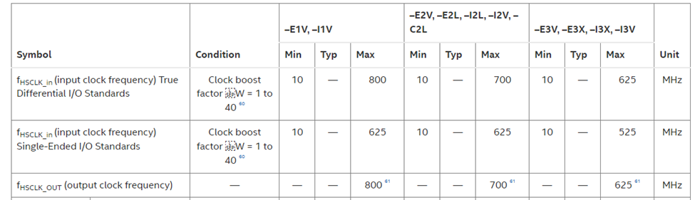

I have found this table in the Startix 10 datasheet which describes the PLL clock maximum input frequencies. However it is un-clear to me whether this table is describing the maximum input frequency from a physical, dedicated, I/O pin/pad or from internal routing along clock nets in the FPGA fabric.
There is a periphery section of the datasheet which may elude to what I'm after. Here it shows that the Highspeed I/O Specifications. For single-ended standards, the maximum frequency is 625MHz. However from how this section reads, I am unsure if this applies to the dedicated clock pins/pads on the FPGA.

According to this Knowledge Base article, refer here Will Altera publish the maximum I/O toggle rate specifications for... (intel.com), unfortunately we are not published the maximum IO toggle frequency in the datasheet for newer device anymore.
All of the standard supported I/O signaling frequencies is depended on design and also system customization form factors.
Therefore, the I/O toggle rate specifications was being removed from Stratix 10 device datasheet. The best options are using HSPICE or IBIS simulations.
