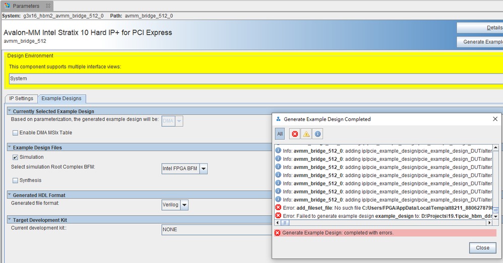

I generate example design of Stratix PCIe hard IP and get error message as following figure.
Could you please fix the problem?

    I'm using v19.1 to generate the Avalon-MM intel Startix 10 Hard IP+ example design by using the default setting, but I can't see the same error.
    Questions:
    1. How do you configure the IP? Does using default settings also having the same issue?
    2. What is the OPN (Device's full name)?
    Regards -SK

      Hi SK,
      1. I got the same errors either using default setting or selecting gen3x8 configuration.
      2. The device full name is 1SM21CHU1F53E1VG.
  • CHung's avatar
    CHung
    I've checked again, it's not default setting. Because we are based on a reference design.
    Please see the attached setting file.
    ​I've tried 1SM21CHU1F53E1VG (our current device) and 1SM21BHU1F53E1VG (reference design), they both failed.
    Thanks.​

    This problem may only happen in certain PC or OS. For a quick workaround, I have helped to generate the design and attached it here for your reference.
    Regards -SK
