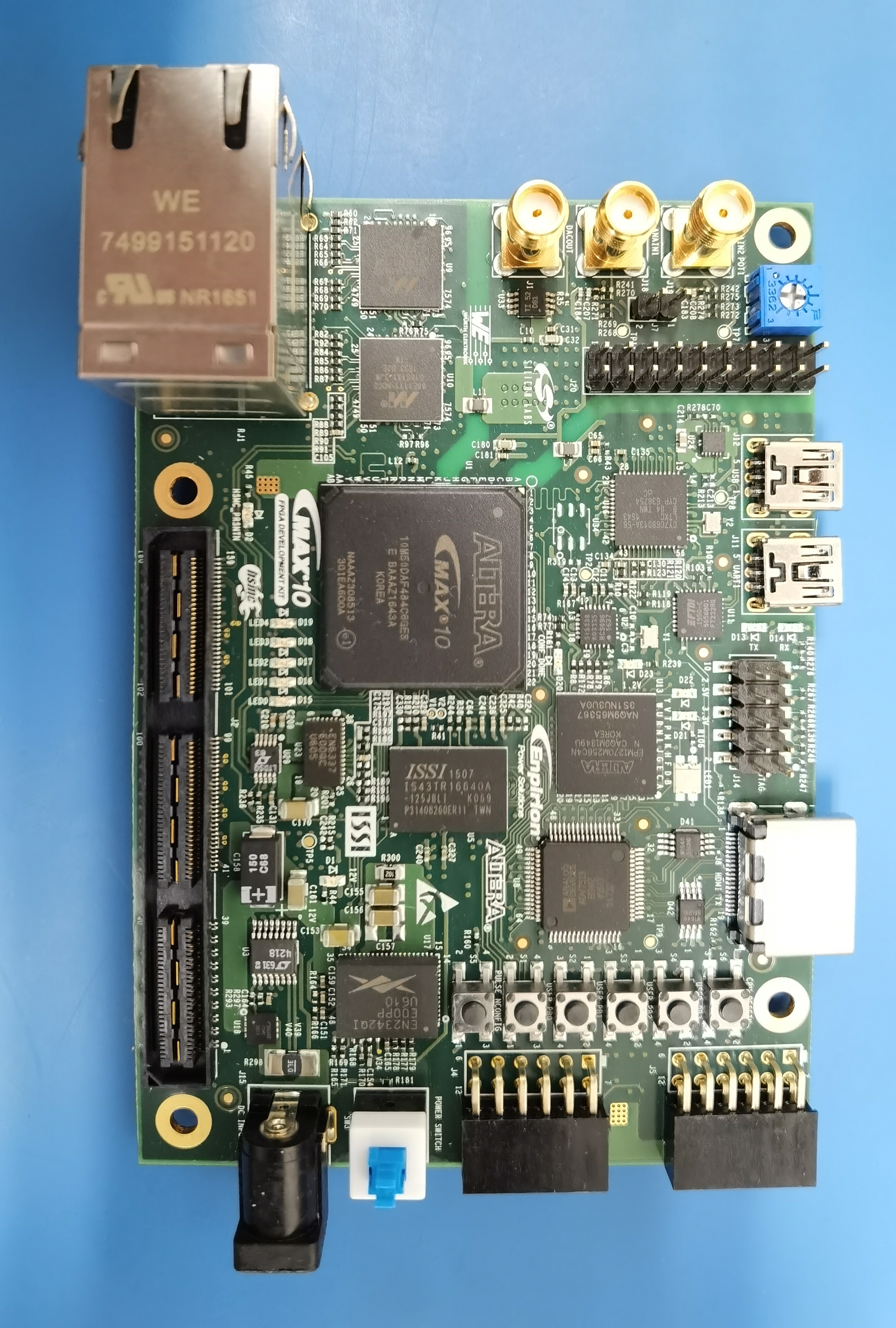

We purchased three sets of MAX10 FPGA develop kit (Part number: DK-DEV-10M50-A) in July 2020 through Mouser.sg.
All these three sets function well when we started deploy our project using the HSMC connector. However, recently , two of them are malfunction in the HSMC connector. Therefore, we want to initiate the service support to replace(or repair) these two malfunction sets. Regarding these two malfunction sets, the SOF files are still able to upload successfuly. Only the HSMC connector cannout output normally as in previous usage.
The devices are operated in lab environment with no physical damage.
Kindly thanks for your reply regarding the solutions.
Attachment is one set with HSMC connector malfunction for your information.

      1. What is the failure symptom?
      The failure symptom is when the FPGA board is turned-on, there is light short-current sound.
      The failure FPGA board is still able to upload the SOF files.
      2. When did the failure happen? How you discover the failure?
      During the measurement, we use micro probes contact with the HSMC pins directly to read data from the pins. At intial measurement, it works well. After several times measurement, it doesn't give any data signal out. The measurement pin will stay high or low for all the time. Then, after turn-on and off again, we hear the short-current sound.
      3. How did you determine the failure? Please elaborate the procedures.
      The failure is determined by the successul measurement of previous several times. And compared with our third FPGA which is still working good with no short-current sound.
      4. Does the failure unit ever working before failure?
      Yes, the failure units ever working before failure.
      5. Did you swap the failure board with a known good board?
      Yes, we repeat the same measurements between failure boards with the known good board.
      Please feel free to let us know if you have any more questions.
