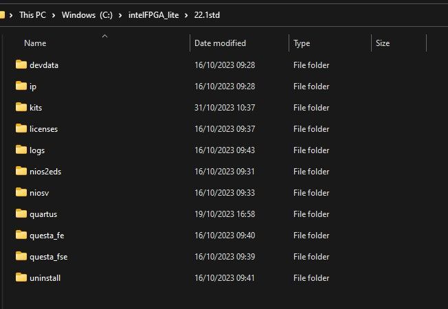

Environment Setup: I've installed Quartus 22.1 on my Windows 11 machine, and it's located at "C:\intelFPGA_lite\22.1std". I've also downloaded Nios II and placed it inside the Quartus installation directory at "C:\intelFPGA_lite\22.1std\nios2eds".
Board Configuration: I've created a "kits" folder and placed my device-specific files within it. This includes folders like "factory_recovery" and "examples". I simply extracted the contents of a downloaded .zip file into this directory.

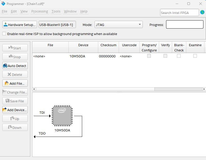

c. In Quartus, through the programmer option, I can see the USB-Blaster connection, and I can successfully program the FPGA board.

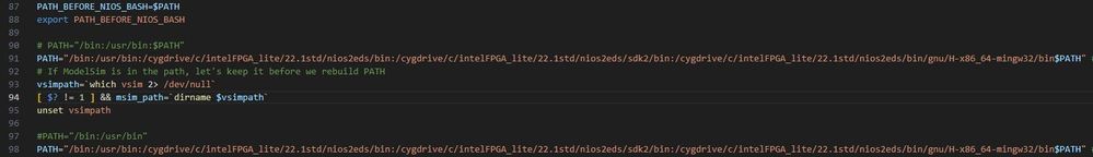

Attempted Solution: I've tried a tip I found in another post, which involves modifying the "nios_bash" file. I changed the PATH variable to the following: PATH="/bin:/usr/bin:/cygdrive/c/intelFPGA_lite/22.1std/nios2eds/bin:/cygdrive/c/intelFPGA_lite/22.1std/nios2eds/sdk2/bin:/cygdrive/c/intelFPGA_lite/22.1std/nios2eds/bin/gnu/H-x86_64-mingw32/bin$PATH".However, I'm still encountering the "command not found" issue.

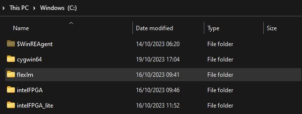

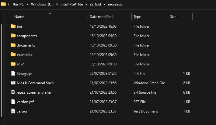

- MAX10_nios2_terminal
Thanks for responding. I upload the follow screenshots of how install directory has been done. the small picture of No JTAG cable is happening when i try to run BTS from the downloaded files from : https://www.terasic.com.tw/cgi-bin/page/archive.pl?Language=English&CategoryNo=218&No=998&PartNo=3#contents . Also we have a picture from quatrus where we see that trough programmer options we can see our FPGA and program it. Also nios2-shell and nios_bash script. Lastly, I want to add that all these paths have been inserted also to the system path. Thanks!!
Thank you very much for your response. I had two versions of ubuntu and i set default 18.04 which as i saw is the one i need and also changed the version to 1 from 2. I also changed the nios2-download file just in case based on the instructions that you send me. Now,
1) Okay BTS cannot work with compatibility options. I do not mind that. But..
2) I want to find the reason why at nios2-shell i cannot run the command nios2-terminal in order to see the IP of my FPGA kit as the user instructions say. My question is the follow: Does a file nios2-terminal has to be exist inside nios2eds folds? cause i cannot find any file in my computer with such a name. Also i have the switches on my FPGA to load default options. Do we need any specific .soc file to be implemented? cause the only one i have based on the terasic site and the basic files is the dual_boot_image.sof.
Thank you again for your time you take to help!!

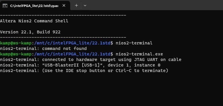

Contributor

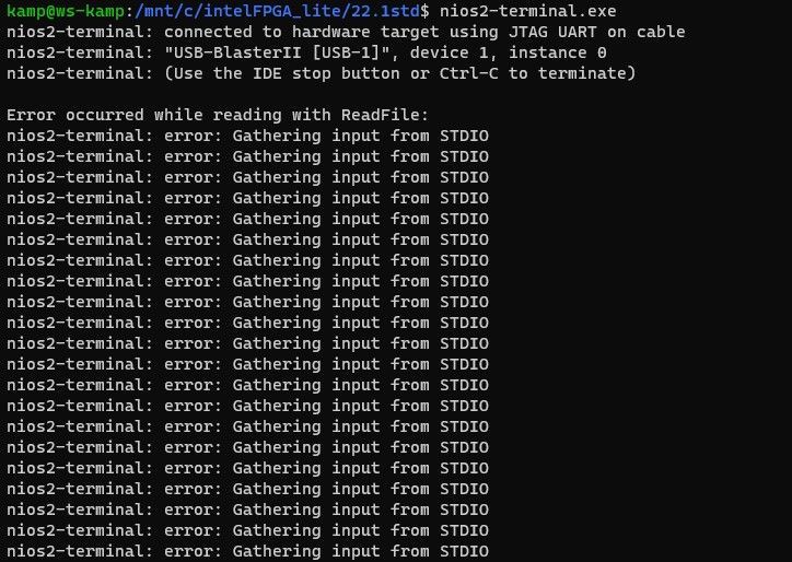

You can try command "nios2-terminal.exe", we want to see the difference between "nios2-terminal".
If i run the nios2-terminal.exe we have the follow result:
Now if i try to type anything after nios2-terminal.exe we have the follow atermonous thing:
and you have to press CTRL+C to stop it.
Kostis A.
- wwanalim_intel
Contributor
It seems the nios2-terminal.exe is working but there is a bug on the system. Unfortunately, version 22.1 is not tested on Windows 11. We would suggest migrating to version 22.3 as it is first Quartus to support Windows 11 and before version 22.4 which has a few known issue.
