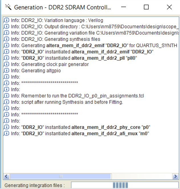

5) generate the DDR2 controller and stuck as illustrated in the captured window.

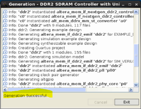

I am able to successfully generate the IP.
You may refer to this KDB which is related to WSL usage. --> https://www.intel.com/content/altera-www/global/en_us/index/support/support-resources/knowledge-base/tools/2019/how-do-i-install-the-windows--subsystem-for-linux---wsl--on-wind.html
You may check on your OS version whereby the recommended OS would be Windows* 10 build version 16215.0 or higher. Also make sure to follow standard instructions from Microsoft® to install Ubuntu* 18.04. The link on the guideline provided in KDB above.
