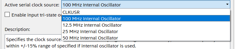

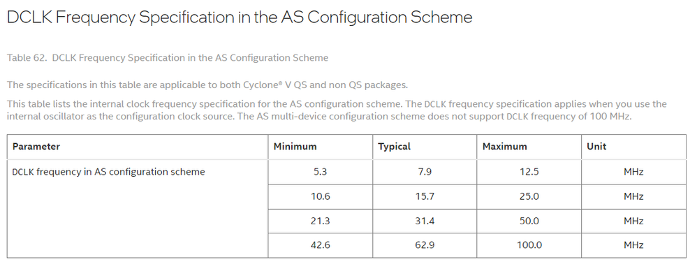

      Ans/ we are relying on the internal clock However, in the datasheet it shows the following
      Are we able to configure the DCLK? And what is the difference between them, I mean why we have many minimums, typicals and maximums?! Now I am more confused, how we choose between them, and how can I learn the configuration time? Or it depends on the FPGA module?
      FYI, We are using 5CGXFC4C6U19I7N with Member code C4, with 50K of logic elements
      The final question, Now, how to calculate the configuration time and what it is for example?

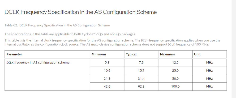

      However, we have four different DCLK frequency in AS configuration scheme as below:
      Why did you use the 42.6 as minimum, why didn't you use 5.3 MHz as minimum as in the figure?
      How to know the certainty of the internal clock generator?
      Thank you so much for your time @FvM
  • FvM's avatar
    FvM
    Because I'm assuming that you are selecting fastest internal oscillator option. It's up to you to make it slower if you want
