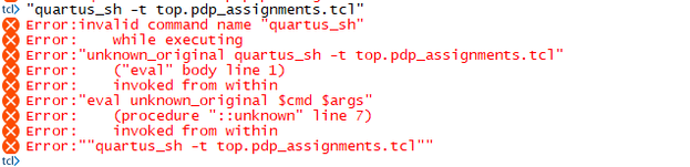

Hi all,
After interface planner, I extracted the tcl file from the tool.
When I put the command into Tcl console in my project, I encountered the error message below:
Wat command I tried input in the Tcl console was as follows:

    Have you set your PATH environment variable to the bin directory of your quartus? Try this and then re-run
    Considering you're using Linux:
    export PATH=$PATH:<installed_quartus_directory>/<version>/quartus/bin
    On Window
    1) Open up your command prompt (cmd)
    2) Type set PATH=%PATH%;C:\altera\12.1\quartus\bin
    Change the back party of the PATH after ';' according to your quartus installation directory
    Then try to run quartus_sh again
    Similar issue found out that might be helping.
    https://community.intel.com/t5/Intel-Quartus-Prime-Software/cannot-execute-quartus-sh-in-command-line/td-p/153115

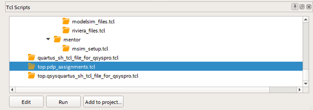

      I could run the generated tcl file with the following add-on window.
      Thank you for your help.

  • FvM's avatar
    FvM
    you are trying to run quartus_sh in Quartus tcl console, but it should be run in Windows command window. If you enter a command in tcl console, you are already inside Quartus tcl shell.
