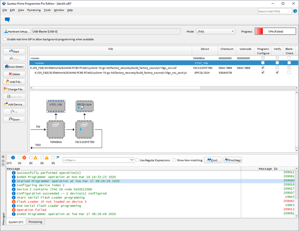

Error on attempt to download sof and jic file to Cyclon 10GX dev. board using JTAG. How to proper setup to get jic file programmed to EPCQL1024?
Using the C10 CVP sample project I added the Serial Flash Loader IP to the design into the top_hw.v.
I setup the jtag chain for the Cyclon 10 GX Dev. Kit, download the 10 design (sof) -> ok and download of the jic file starts -> error Flash Loader IP not loaded on device 3. AS is enabled (S1.x default). Unlike with other designs detecting of the jtag chain does not show the epcql1024. The cyclon 10 design is loaded with the right jtag usercode, as a try.

    Thank you for your prompt answer. I tried to download as proposed and I am afraid it did not work. See screenshot below. A very worring thing is the readme file in the factory_recovery folder, containing the following sentence: "Note: .jic file cannot be programmed via Quartus Prime Programmer at this moment, will be fixed later in v18.0 or later build." Is this working indeed now?

    I observed that you are still not programming the SFL image into the Cyclone 10 GX device. Below is the screenshot that you should observed.

    I seem to miss something. Obviously I took the c10gx_sss.sof file found in the build_factory_source folder. What you are telling me is this is not the right image to take? How to choose the "right" design to do so?
