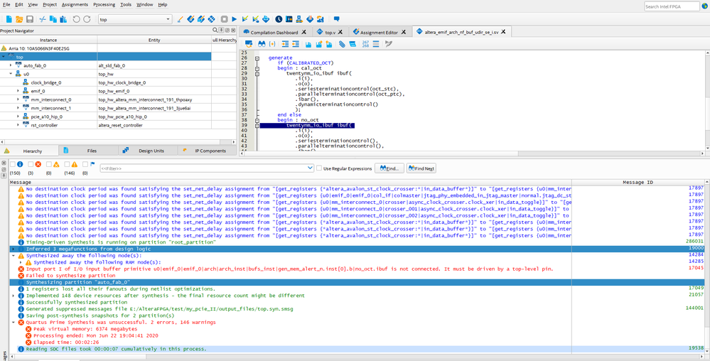

Error (17045): Input port I of I/O input buffer primitive |emif_0| .. |gen_mem_alert_n.inst[0].b|no_oct.ibuf is not connected
I'm writing an project to access system ddr4 (read & write). In Quartus Pro 19.2 Platform designer, I added "EMIF IP" inside, and add a top.v as well.
But when trying to compile, it reports some err message as following:
"Error (17045): Input port I of I/O input buffer primitive u0|emif_0|emif_0|arch|arch_inst|bufs_inst|gen_mem_alert_n.inst[0].b|no_oct.ibuf is not connected. It must be driven by a top-level pin. File: E:/AlteraFPGA/test/my_pcie_II/platform/top_hw/ip/top_hw/top_hw_emif_0/altera_emif_arch_nf_191/synth/altera_emif_arch_nf_buf_udir_se_i.sv Line: 39
Error: Failed to synthesize partition
Info: Synthesizing partition "auto_fab_0"
What does this error mean ? And HOW to fix it ? thanks ~
  • continue ..
