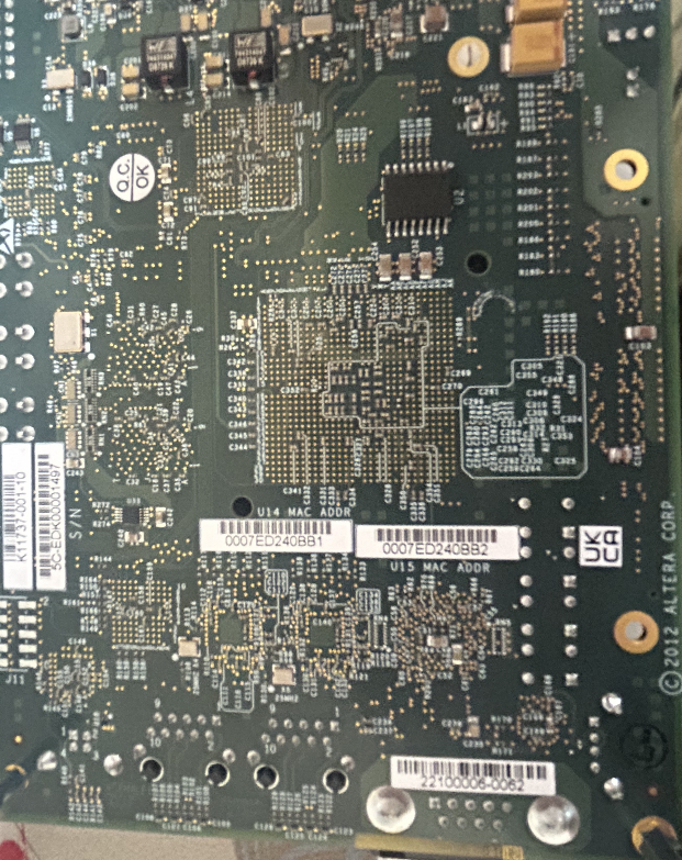

  • totolo's avatar
    totolo
    I encountered the same issue, the JIC programming failed, and I can't even erase the flash. The component at the U2 position on my C5E development board is not an EPCQ256 but a 2WA15 RW164. How should I deal with this?
