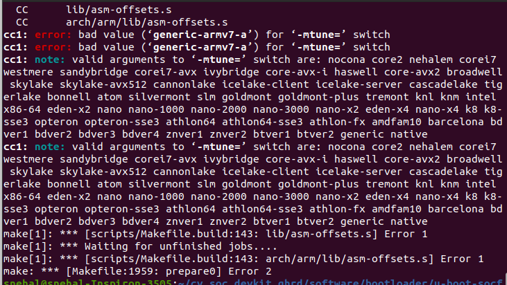

We want to build boot image for customized cyclone V SoC board.
We are following the below document, using Quartus Prime 22.1 Standard Edition on Ubuntu 20.04 system,
We are getting below error while building uboot
/usr/bin/ld: tools/imagetool.o: in function `imagetool_get_type':
imagetool.c:(.text+0xa): undefined reference to `__stop_image_type'
/usr/bin/ld: imagetool.c:(.text+0x12): undefined reference to `__start_image_type'
/usr/bin/ld: tools/imagetool.o: in function `imagetool_verify_print_header':
imagetool.c:(.text+0x73): undefined reference to `__stop_image_type'
/usr/bin/ld: imagetool.c:(.text+0x7a): undefined reference to `__start_image_type'
collect2: error: ld returned 1 exit status
make[1]: *** [scripts/Makefile.host:104: tools/dumpimage] Error 1
make: *** [Makefile:1900: tools] Error 2
Can you please share your insights.
