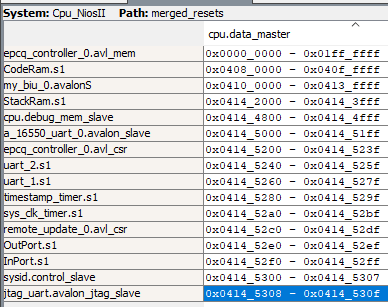

there are saved addresses in Avalon MM BUS when Nios2/f is the master?

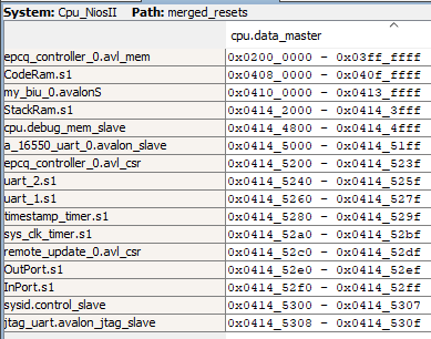

I'm asking because when I click in Platform Designer on "Assign Base Addresses", the tool change the Addresses of "epcq_controller.avl_mem" from 0x0000_0000-0x01FF_FFFF to 0x0200_0000-0x03FF_FFFF.

Before:
After:

  • I don't think there is a list of address exist, if you want to keep the unchanged address, you can click the little lock icon in the Base Address column in Platform Designer to prevent assigned addresses from getting changed when you use the "Assign Base Addresses" command.
    The "Assign Base Addresses" automatically assigns unique base addresses to all the slave interfaces/ports in the Qsys Pro system, allowing the system to avoid conflicts for all memory-mapped component interfaces.
    Do note that there is no guarantee that "Assign Base Address" would solve addressing problems. If the master does not have enough address space for its slaves, then no amount of assigning base addressing would work. The user is expected to modify their master/slaves to ensure proper sizing is used.

      I understand your explanation about the Avalon MM addresses but ,I still don't figure out why the tool start to give the slaves addresses from 0x0200_0000 and not from 0x00. It seen like another component that take the addresses range (0x00 - 0x01FF_FFFF) to himself and it don't show to the user.

    I don't know this for sure because I haven't experimented with it, but based on your example, the command may be trying to minimize the size of gaps in the address map instead of just always starting from 0. You still have a gap, but it's obviously smaller with that interface starting at 0x2000000.
