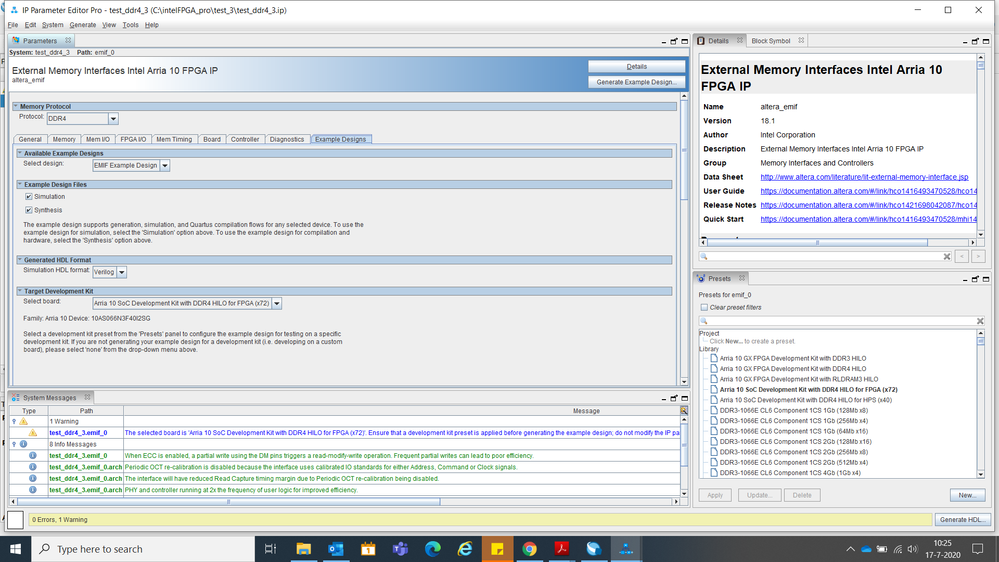

I am trying to use the external memory interface IP and when I choose a device in the presets on the IP Parameter Editor (for arria 10 SoC) the arria 10 device family is not the same as the one in my board (10AS066N3F40E2SG).
Here is the kit OPN#: DK-SOC-10AS066S-A.
Am I doing something wrong? What should I do?

That's what I was referring to: the device family from the preset is not the same as the SoC board I have...
But I programed the device i have with the example and it seems to work fine.

If you want to guarantee you're using the correct implementation and parameterization for your board, instead of choosing the preset from the parameter editor, use the example memory design that is included as part of the software download for the board.
