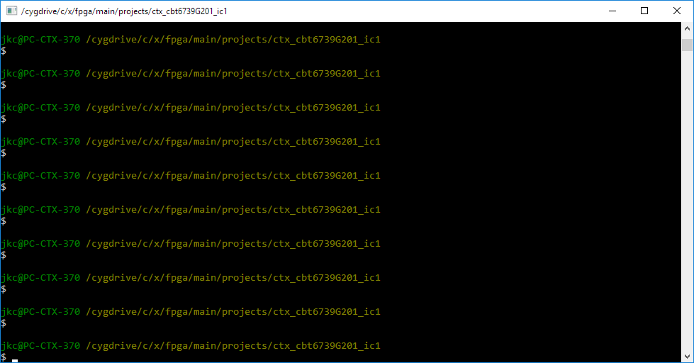

I am trying to use quartus_sta on a MAX 10 project in Quartus 18.1, but I am getting an error, see error.png It happens when I in the constrainer set the data rate to Double data rate, see constrainer.png. I aperas to me that Intel/Altera have renamed the DDR register but have forgotten to update the quartus_sta script, see ddio.png

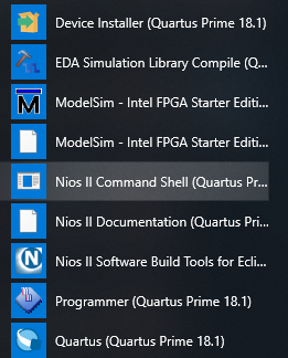

How do you come to this page? Can you show us more screenshot? - KennyT_altera

Thanks, I was able to launch it.. can attached over your design.qar as well? Otherwise I will have to create it.

This seems to be a bug, however, Quartus std version are only in maintenance mode. There will be no fix on the bug because in pro edition there are no longer soft LVDS.
What you can do is write the sdc file on your own. https://www.intel.com/content/dam/www/programmable/us/en/pdfs/literature/ug/ug_altlvds.pdf page 45.
We will file a kdb to let other customer know on this.
