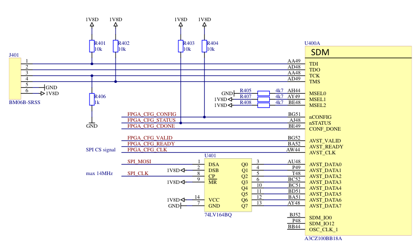

We are trying to program an Agilex 3 device over the AVST8 interface, implemented through a CPU using SPI and bit-banging.
Setup (see picture below):
  • Data is shifted into a serial-to-parallel converter via SPI.
  • AVST_CLK is generated from the SPI CS signal.
  • AVST_VALID and AVST_READY are controlled by GPIOs.
  • With this setup, we can mimic the passive serial programming approach used on Arria FPGAs.
What works:
  • Programming and testing over JTAG works fine.
  • The FPGA design itself runs correctly.
What does not work:
  • During AVST8 programming, AVST_READY goes low after ~8210 bytes and never returns high.
Programming sequence we follow:
  1. CPU initializes pins: nCONFIG=0, AVST_VALID=0
  2. CPU sets nCONFIG=1
  3. FPGA pulls nSTATUS=0
  4. CPU sets nCONFIG=0
  5. FPGA sets nSTATUS=1
  6. CPU provides some clock cycles (~81 cycles) on AVST_CLK (since AVST_READY is low)
  7. FPGA sets AVST_READY=1
  8. CPU sets AVST_VALID=1 and streams configuration data
  9. After 8210 cycles, FPGA sets AVST_READY=0
  10. CPU sets AVST_VALID=0 and continues clocking
At this point, AVST_READY never goes high again.
What we observed:
  • If we deliberately corrupt the configuration data, nSTATUS goes low after a few cycles — as expected.
  • This suggests that the FPGA is checking data integrity, but something prevents AVST_READY from recovering.
  • Our bit-banged AVST_CLK frequency is only about 60 kHz. Could this low frequency be the root cause?
Question:
Why does AVST_READY stay low after 8210 bytes? Is the slow clock (60 kHz) causing the issue, or are we missing something in the programming sequence?
Thanks in advance for your support!

  • Farabi's avatar
    Farabi
    Can you try higher frequency for AVST_CLK? 60kHz is too slow. Can start from 1MHz.
    You can also keep AVST_VALID -> high during streaming, even after AVST_READY goes low.
    Only send the idle clock cycles after AVST_READY goes low, with AVST_VALID = 0.
    Please check signal condition with oscilloscope, is it clean or too noisy.
    regards,
    Farabi
