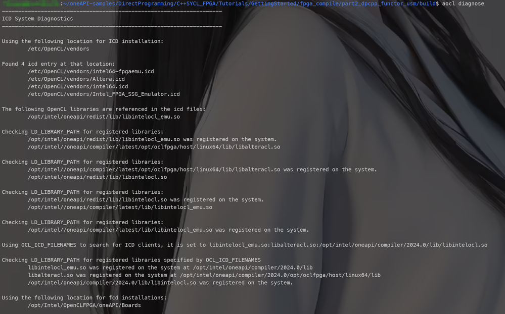

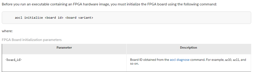

The document says that Board ID obtained from the aocl diagnose command.

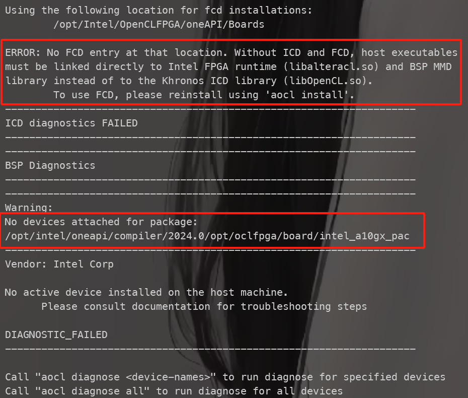

I run aocl diagnose command, and I get the following result:
Is the error because I am missing any software packages?
My card is Agilex DK-DEV-AGI027RES.

Does this card Agilex DK-DEV-AGI027RES have a corresponding BSP?
And where am I going to download its BSP? I couldn't find the download link on the official website.
Thanks!
