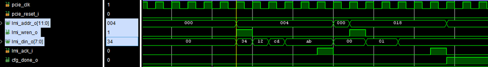

Hi, I have used Intel Arria 10 Avalon Streaming Interface for PCI Express Hard IP as the root port for my design.
I was able to get the PCIe Link Up signal (LTSSM state L0 state is high),
But while writing the configuration register space with some data i was not able to get the lmi_ack signal back.
Is there any reason why that acknowledgment (lmi_ack) is not getting generated even after the data is written to the configuration space register correctly?

To ensure my logic is correct I had simulated my code there it is working fine. Please find the attachment for simulation result.

Can you please make sure that, whether LMI interface signal can be used for root port configuration space register write operation?
- sgr
"Could please try to change/adjust the input signal and see is it the same thing happen?"
Yes i have tried with different input but acknowledgement is not coming
- Wincent_Altera
- LMI Write operations are provided for AER header logging, and debugging purposes only if refer to the user guide
From what I understand, the lmi_ack (Acknowledge signal) normally will sent back when execution is complete.
Can you please check back is anything wrong with the execution part?
Wincent_Intel
- sgr
Hi Wincent_Intel,
But we are using LMI write for Root port configuration space register operation, may be for that reason it is not working??
- Wincent_Altera
Yes, to your answer.
Can I know why you need to perform that action ?
Wincent_Intel
- sgr
Hi Wincent_Intel,
Because initially I want to configure my Root port configuration space register with appropriate value and then I want to configure my endpoint register space. So, to configure the Root port configuration space register i need LMI Write interface.
- Wincent_Altera
Hi ,
Sagar, Thanks for sharing, but as mentioned in the User guide the LMI Write function are for debugging purpose.
The function might be limited if you need to perform the feature as needed.
Based on my understanding An acknowledge signal is sent back to the Application Layer when the execution is complete.
Can you please check if the execution is complete or stuck anywhere else?
