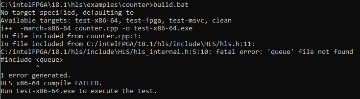

After running the init_hls.bat I thought I am ready to run one of the first examples. So I picked the 'counter' project provided in the <quartus install dir>\hls\examples\counter folder. But when running the build.bat file I always encounter the following error:
I did some research through the web to solve this issue. Some stated that a different command prompt should be used to overcome this issue. Some said that you need to specify the correct paths. But so far I was not able to solve this issue. Can someone give me a hint what I can do so that the HLS compiler is able to find the correct paths for the standard includes?

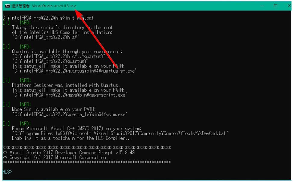

    During my research of what could go wrong I already came across the link you have posted. In regards of the required tools I have already everything installed and setup. Depending on this it should already work, but it does not. I don't know how the HLS compiler knows which C++ compiler should be taken. I guess this is somewhere configured in the Quartus installation.
    Another thing I saw is that on the link you have posted, they use a special HLS command prompt from Visual Studio 2017.
    Do you know where I can start it from?

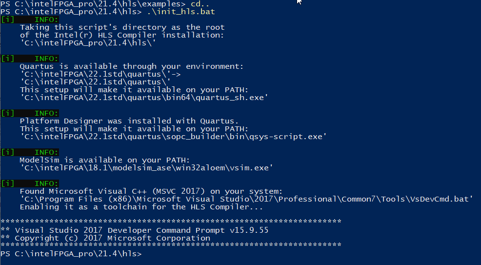

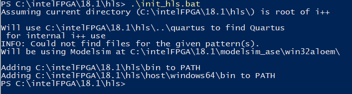

    3. The following screenshot shows the output of the init_hls.bat:
      It looks quite different from what is shown in the document picture. But I'm not sure if this is the root cause of my issue.
    Thanks for your help!

    I'm now one step further. I now have downloaded and installed a new version of Quartus, including HLS compiler. I'm now runnning on:
    • Quartus Prime Version 22.1std
    • Intel HLS compiler version 21.4
    When running the init_hls.bat I get the following result:

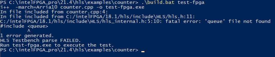

    After now successfully running the init, I tried again to run the 'counter' example from the HLS compiler installation. But I still get the same error when running the build command:
