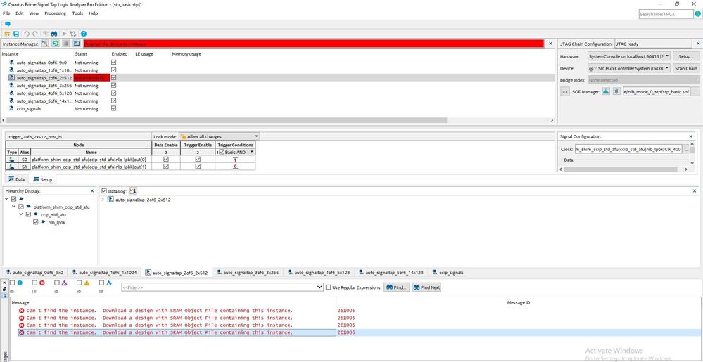

then we open stp_basic.stp was able to choose “System Console on … Sld Hub Controller System and jtag is reday.but keep asking me to program device to continue as in the firt picture.
also there is warning
Error(261009): Cannot run Signal Tap Logic Analyzer. Signal Tap File is not compatible with the file programmed in your device. The expected compatibility checksum value is 0x76AF59AF; the value read from your device is 0x9DDC57FD

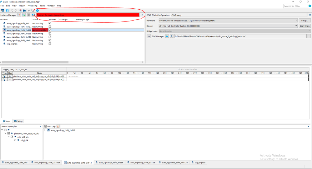

then we open stp_basic.stp was able to choose “System Console on … Sld Hub Controller System and jtag is reday.but keep asking me to program device to continue as in the first picture.
also there is error.
Error(261005): Can't find the instance. Download a design with SRAM Object File containing this instance.
so I think nlb_400.gbs.gbs has no stp file included.
