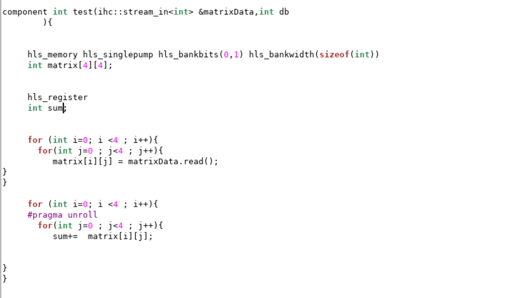

1. Can I call another component from within a component similar to instantiating another rtl module within a module?
2.
In the above code snippet I am calling the test twice from the main module. The second time I want to accumulate the sum with the sum from the previous call. But it is not happening. The sum register value is automatically set to 0 every time when component test is called. It's not holding the value from the previous call. Is there any way to achieve this?

    Try declaring "sum" as "static".

    Please find the response to your doubts as followed 1) yes I believe you can do so, but per my understanding you would like to prevent too much nested layer of component calling as it might impact the performance, 1-2 layers should be ok. 2) as mention by HRZ, declaring the sum as static will allocate it for lifetime of the program and will be shared.

    I tried declaring the variable as static and it worked. Right now I've decided not to nest the components so I won't try it now.
