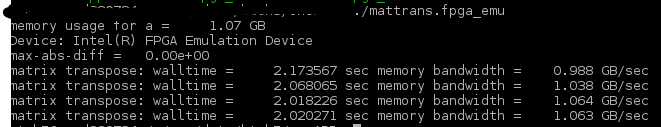

Apologies for the confusion, with the provided source code we have managed to successfully run the emulator compilation. With that we can rule out the issues on the code.
