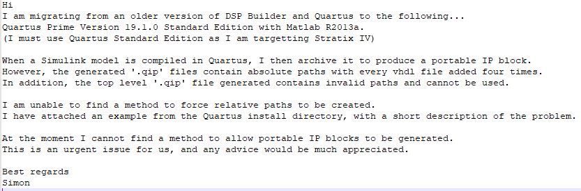

    Hi I have attached an image of the text of my request as the forum corrupts it each time i type it in
