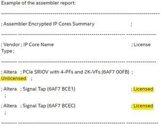

Once you run your project compilation, Quartus will automatically create a assembler report, .asm.rpt file.
( The assembler report is located in <Project directory>/Output_files/<project_name>.asm.rpt.)
This report will show which IP license that you do not have, then you may proceed to select the IP to purchase.

Did you manage to generate the Assembler report?
From the report you can see similar view as below to see which is license or unlicensed:
Assembler report example

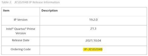

Based on the JESD204B Intel® FPGA IP User guide under chapter 2.1 Release information, you can see the ordering code for this IP is "IP-JESD204B". You may share the assembler report and User Guide to double confirm with your distributor.
JESD204B Release information
You may refer to below link for more information:
JESD204B Intel® FPGA IP User Guide - 2.1. Release Information
