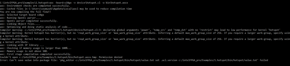

Compilation Failed For s10gx: Couldn't open hotspot.aocx.tmp: Permission denied Error: Can't save value into package file: 'pkg_editor value.txt set .acl.version value.txt' failed
I'm trying to compile the design for s10gx on Quartus Prime 19.1 and Opencl sdk 19.1
The emulation works successfully. But when I am trying to compile the design for s10gx I get and error:
Couldn't open c:/intelFPGA_pro/Examples/1.hotspot/bin/hotspot.aocx.tmp: Permission denied
Error: Can't save value into package file: 'pkg_editor c:/intelFPGA_pro/Examples/1.hotspot/bin/hotspot/value.txt set .acl.version c:/intelFPGA_pro/Examples/1.hotspot/bin/hotspot/value.txt' failed
I have attached a screnshot too.
Does anyone know how to solve this?

  • SDesh12's avatar
    SDesh12
    Hey HRZ,
    I'm running the commands using the admin cmd prompt. I also checked the permission of my target folder, it is set to "Everyone".
    But the error regarding the permission is not solved.
    The compilation is completed successfully while emulation but not for s10gx.
    Do you have any other solutions?
