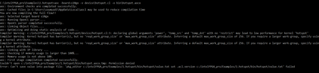

Compilation Failed For s10gx: Couldn't open hotspot.aocx.tmp: Permission denied Error: Can't save value into package file: 'pkg_editor value.txt set .acl.version value.txt' failed
Hey HRZ,
I'm running the commands using the admin cmd prompt. I also checked the permission of my target folder, it is set to "Everyone".
But the error regarding the permission is not solved.
The compilation is completed successfully while emulation but not for s10gx.
Do you have any other solutions?
