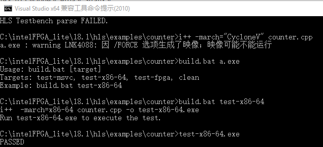

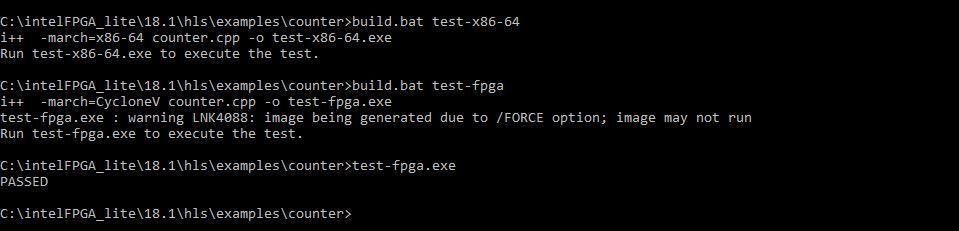

i'm using Quartus Prime Lite Edition 18.1, MS Visual Studio 2010 pro, Windows 10 OS. My problem is "I could create test-x86-64.exe / test-fpga.exe and those are passed successfully.
But the compilation is always unsuccessful ( .QPF file where created in ...-fpga.prj folder) on Quartus Prime Lite 18.1. The reasons are different which are depend on the example type." I could not find the same question/answer on the internet and in the intel forum. where is my fault?

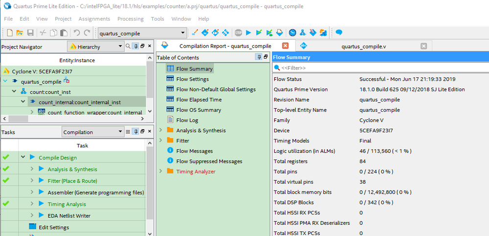

in my situation, refer session 7 was more useful than 8.1 from https://www.intel.com/content/dam/www/programmable/us/en/pdfs/literature/hb/hls/ug-hls.pdf.
You were right. My test-fpga.exe (test-fpga.prj) was created on Arria10. but I was trying to compile it on Cyclone IVE device family on QPLite. After your answer, i tried on CycloneV device and it compiled successfully. Thank you again.
